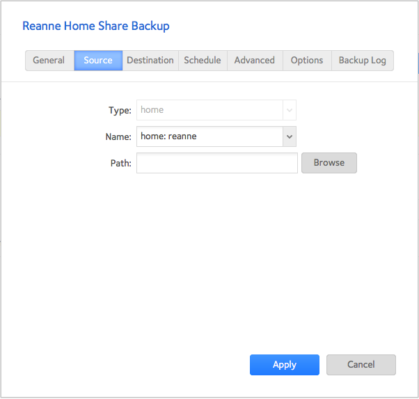

I tried a push backup from the Pro 6 and get a different error. Here are screen shots:
This is the Pro 6 source entered using the browse button:

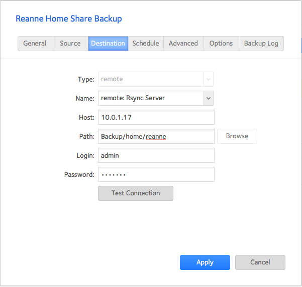

This is the 104 destination. Rsync is enable for the backup share and test connection is successful:

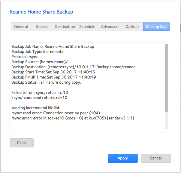

Here's the error log:
I'm stumped. Thanks for your help!

The second example was a backup job on the Pro 6, attempting to push a single home directory to the 104.
The 104 has an Rsync enabled backup share with a home directory for the backup target. The destination connection is successful on the Pro 6.
The error is an rSync socket error:
rSync error
