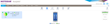

How to copy data from the one harddrive to another within the same readynas?
Hi, I have a ReadyNas RND2D running firmware version 6.10.1 in X-Raid mode and I had only one 1TB drive inserted into it. Everything is working fine but my drive is almost full. So I purchased a new...

Apr 26, 2022Guru - Experienced User
ekot wrote:
Hi,
I have a ReadyNas RND2D running firmware version 6.10.1 in X-Raid mode and I had only one 1TB drive inserted into it. ... So I purchased a new 2TB drive and inserted it into the second channel. After doing this my system has resynced (I have not rebooted it yet) but the storage capacity stays the same.
That is what is supposed to happen. The NAS uses RAID, and when you use the default XRAID, the second disk adds RAID redundancy (RAID-1 mirroring), not more space.
You can get a 2 TB volume by purchasing another 2 TB drive. Then remove the 1 TB drive with the system running, and hot-insert the replacement. The NAS will resync the existing 1 TB of space first, then expand the volume to 2 TB.
You could also back up your data, and then switch to flexraid. You can then create two volumes (one for each disk), and put some shares on each. Then restore the files from your backup.
