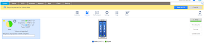

Hi, I have a ReadyNas RND2D running firmware version 6.10.1 in X-Raid mode and I had only one 1TB drive inserted into it. Everything is working fine but my drive is almost full. So I purchased a new...

Hi StephenB ,
Thank you for your reply.
I want to double check a few things before removing the old 1 TB.
At the moment, in my understanding, all the data is stored in the 1 TB.
When I inserted my new 2 TB harddrive, it was synced for three days. What did it do?
If I understand correctly about your words "the second disk adds RAID redundancy (RAID-1 mirroring), not more space.", it means by that now the data from the old 1 TB has been copied over to the new 2 TB. Am I correct?
I have bought another 2 TB harddrive, do I need to restart or do anything in the admin page before opening the case and removing the old 1 TB to replace it with another 2 TB harddrive? I only have two harddrive slots in my NAS.
