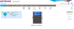

how to format HDD and wipe all data
Hi, I would like to Wipe my HDD and Format all the data and reusing it again the format button is inactive but the DESTROY is active if I choose destroy then what next step will I be abl...
- Both HDDs?
- Do you want to create a new volume in the NAS? Or reuse the disks in another device?
- Do you have any apps installed on the NAS?

- StephenBOct 03, 2024Guru - Experienced User
makkistyle wrote:
I have one app installed (Plex)
Then begin by uninstalling it. It uses a hidden folder on the data volume, so it will need to be reinstalled after you create a new volume.
After that, use "destroy". You can then format them from the web ui, and create a new volume.
Once that is done, you need to recreate the shares, reinstall plex, and restore your files from a backup.
makkistyle wrote:
but would be different if I'm going to transfer the HDD to another NAS ?
"Destroy" would still be the place to start. If you are moving to another manufacturer's NAS, you'd need to format it in their system. ReadyNAS systems include a small OS partition and a swap partition that are not part of the data volume. You'd need to remove those also, and the process above doesn't do that.
FWIW, if you were selling the hard drives, I'd suggest zeroing them before sale.
