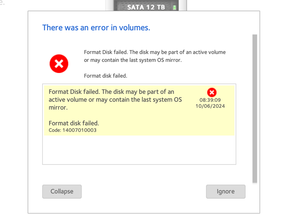

- makkistyleOct 05, 2024Tutor
ok I decide to do what you suggested
the DESTROY worked fine
I selected the upper disk and clicked Format and worked fine
but the second one it did not format it shows this error :
shall I ignore and take out both disk to format with MAC
