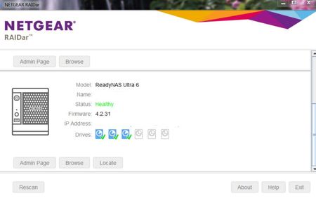

How to upgrade from OS 4.2.31 to OS 6 on a Readynas Ultra 6
Can anyone provide me with the steps to upgrade from OS 4.2.31 to OS 6 on a Readynas Ultra 6. And do I have to update the BIOS as well before the upgrade? Thanks.
