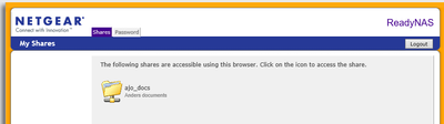

  • I can not access ny NAS folders that are mapped in File Explorer. They are simply not accessable any more.
  • I can access my own "share" folder on the NAS (at least from IE-browser), but even if I log in as admin + netgear1, I will only open this browser.

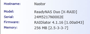

    It's a Netgear ReadyNAS Duo RND2000v2.
    Per your screenshot, it is the original ReadyNAS Duo (called a v1 here).
    It is important that we get the model right - your options for dealing with the SSL version problem are different for the two models.
    The original Duo (v1)
    • runs 4.1.x firmware
    • says ReadyNAS Duo on the front panel
    • often has other labels that suggest it might be a v2 (or even a v3).
    The Duo v2
    • runs 5.x firmware
    • says ReadyNAS Duo v2 on the front panel

      • The lable on the item still says that it is a "ReadyNAS Duo RND2000v2", but it doesn't say v2 on the front.
        When I look in Frontview it says it has the latest Firmvare and it is 4.1.16, so you might be correct that it is a v1... strange...
        It´s really confusing which version it is...
