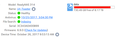

Increasing Capacity of RN314
I am about to upgrade my RN314. It came with 4 3TB drives and is getting full. I have searched around on the Netgear support and this community and did not see any clear instructions so I wanted to ...
