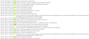

Issue Replacing Disks | RN316 automatically shut down instead of rebuilding RAID array
So is this normal behaviour? Or is this a bug in the software?
I have a RN316 with 6 x 4TB HDDs ina a RAID 5 configuration.
There is less than 5% free space left.
So I want to replace all o...
StephenB
Dec 04, 2018Guru - Experienced User
Platypus69 wrote:
Is this a bug that the RN316 automatically shuts down instead of continuing the rebuild of the RAID set?
Please look on system->settings->alerts in the admin web ui, and let us know if the checkbox next to "Shut down the system when a disk fails or no longer responds" is checked.
It does sound like there is a bug (the disk insertion/RAID rebuild should have canceled the shutdown), I suggest clearing that particular setting - at least while you are doing the upgrades.

Thanks!
You are correct, the "Shut down the system when a disk fails or no longer responds" is checked.
Although, similar to your reply, it seems to me like a bug as it should cancel the shutdown if a replacement HDD is inserted within the 30 minute grace period.
