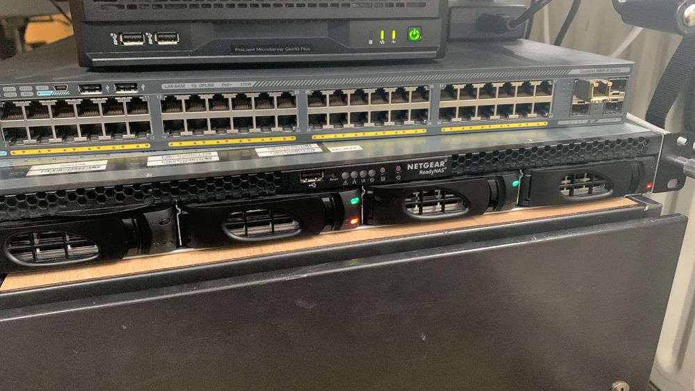

Dear users,
I am in desperate need of some advise.
My Netgear RN3138 with readyNAS is i think in a bootloop.
i do not know what the led patterns mean.
Disk 1 = Off
Disk 2 = Green / Red
Disk 3 = Green
Disk 4 = Red
I tried to do a OS reinstall but the reset button doesnt do anything.
I have 4 WD enterprise 4 TB disks in it.
And it goes from 100% fanspeed to 0% fanspeed. then again to 100% and to 0%. continuously.
network connection is not possible. The lights above the disks stays off.
Does anybody know what this kind of behavior means?
Im sorry if im in the wrong section
photo:
https://gyazo.com/57afe1c25ac70975cccfde2d4eb6ce2a
  • nels538 wrote:
    it just keeps giving me these LED's immediately when i poweron the machine.
    Even with no disks?
    nels538 wrote:
    Will it work if i put the drives in another RN3138?
    If the RN3138 chassis has failed, then the disks might work in another RN3138 (or any other OS 6 ReadyNAS chassis with enough bays).  The OS and settings are all on the disks.
    I say "might" because whatever caused the failure might also have corrupted the disks.
    RAID recovery software that supports BTRFS (ReclaiMe for example) might also be able to off-load data, though that you'd need to be able to connect all the disks to a Windows PC.
    If you are looking for a used RN3138 you need to be careful - some of those units had defective CPUs.  There's a service action here that gives you some information on what serial numbers were affected: https://kb.netgear.com/000037344/Service-Note-for-RN3130-RN3138-WC7500-and-WC7600v2

  • StephenB's avatar
    StephenB
    Disk 1 = Off
    Disk 3 = Green
    Disk 4 = Red
    See pages 41-42 here: https://www.downloads.netgear.com/files/GDC/RN2120/ReadyNAS_OS6_Rackmount_HWM_EN.pdf
    Have you tried installing RAIDar on a PC, and looking at its status? https://kb.netgear.com/20684/ReadyNAS-Downloads#raidar
    • nels538's avatar
      nels538
      The NAS is not reachable via network.it seems that it is not booting at all or is stuck on a boot loop.
      Turning it off and on again does not work even with powercord detached.
      please see added picture. i cant figure out what these LED's mean. If it is trying to tell me a error code or something.
      • StephenB's avatar
        StephenB
        Try
        1. removing power
        2. remove the disks (labeling by slot),
        3. and then power on the NAS.
        See if RAIDar then reports a "no disks status".
        If you can connect the disks to a Windows PC (either with SATA or a USB adapter/dock), you can also test them WD's digital dashboard software (or perhaps the older Lifeguard).
