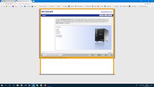

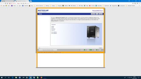

I updated the software several months ago now when I go on the web through setup to check out the condition of my nas I just get the front page with no active buttons. see pic

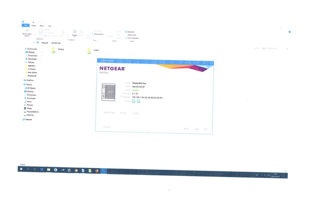

Understood. I wanted to know if RAIDar was detecting your NAS, and what status information it was giving.
Also, can you access the data using file explorer (or finder)?
- godders7Jul 24, 2018Aspirant
Its detecting my nas OK see pic
