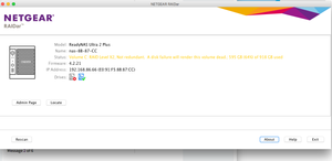

Using this ReadyNAS with two drives inside it in a Mac system. It's exhibiting problems showing up on Raidar, etc. It finally booted up and I get this warning on Raidar: I need to understand...

You already asked the RAID question on another thread. XRAID with two disks uses RAID-1. Disks are numbered left-to-right, so you are correct in thinking that the error is with the leftmost disk.
I'd log into the actual admin web ui using https://nas-ip-address/admin (substituting the actual NAS IP address), and also look in it's logs to see what's going on with disk 1. You can download the log zip file from the logs page, and look in disk_info.log and smart_history.log. That will also give you a more precise idea on what's failed. You can post back questions (and cut/pastes from those logs) if you aren't sure what they are telling you.
To replace the disk, you remove the disk, and take it out of the drive tray. Put the new disk into the drive tray, and then insert it into the NAS. Do all this with the NAS running.

Got the new drive and I basically just hot swapped it for the dead drive (on the left in the chassis). I left it running overnight and as of this morning, the Readynas doesn't seem to be doing anything with the new drive I installed. I use the app that launches (a recently downloaded "Raidar" download. See image in my first post in this message stream). The info in the window is identical and hasn't changed. Still says the left drive is dead and isn't recognizing the new drive. Anything I can do about this?
Thank you.
