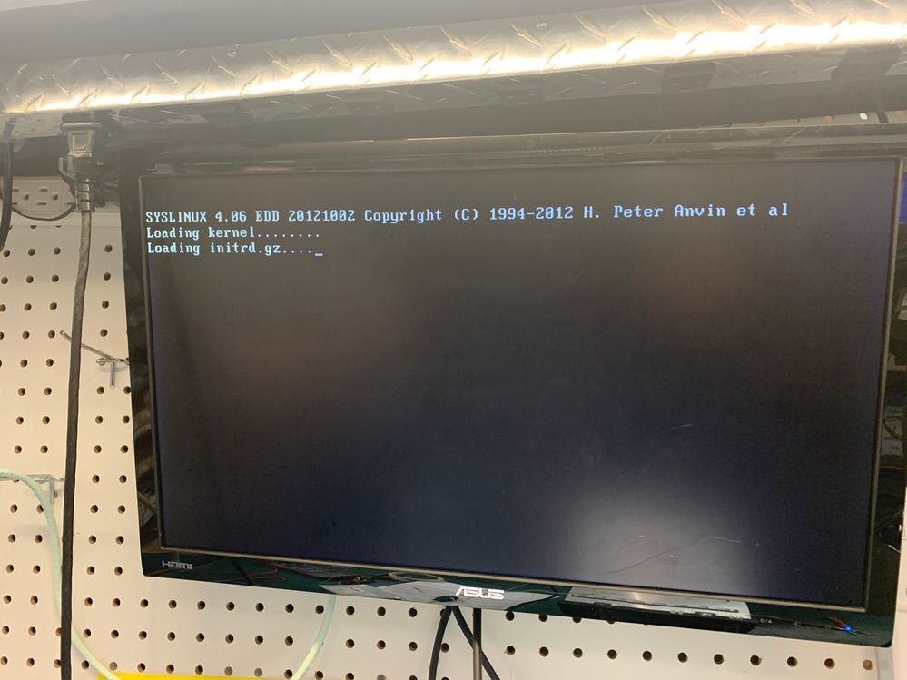

I tried to do OS reinstall by trying to enter boot menu, but it wont even get to boot menu, attempted USB recovery method -no luck, tried to boot with a free spare disk - no luck again. Dispay monitor throws message till "Loading initfs.." as I shown in the previous screenshot and then thats it.
I think this device is beyond my hope now and I wasted too much time.

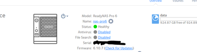

The current firmware version on PRO6 is 6.10.7
Then the PRO6 has already been converted, so you don't need to convert it again.
What you do need to do is remove the disks from the RN516 trays, and put them into the Pro-6 trays. Then insert them into the Pro-6 (ideally in their original order), and power it up.
