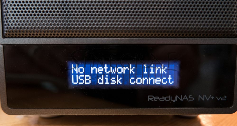

no network after lightning strike
No network link no network activity lights USB backup works So disks and RAID systems work (Raid5 4x3TB now 4,2/8,1T free) So a simple solution could be to move the disks to a new 4Bay Read...

if it does a "smart" scan then it gets the disk type and serial number .. now i don't know if it works over USB ..
I tried to rename 6TB to the same name as 1TB disk ..
but the same results as before, "USB disk connect"
but no light on the backupp button..
holding the button in 6sec so it says "USB mount faild"
I only got the first TB'n, again on the little HD..
