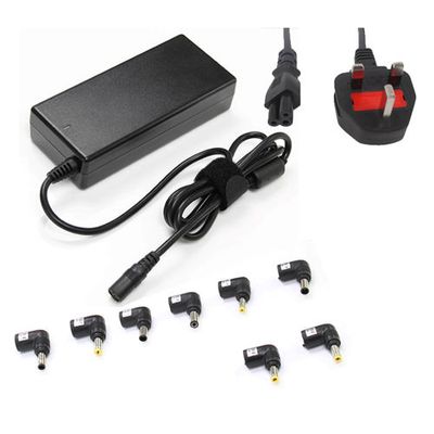

    If you are lucky, the lightning strike killed the adapter before it could reach the router.
    Netgear does not sell replacement power adapters. Any generic adapter will work. Just get one with the right volts, enough amps and a tip with the right (+/-) polarity and dimensions to fit your hardware. Some adapters come with an array of different tips.
    Generic adapter
    The details you need should be on the old adapter, on a label on the device itself and in its manual.
    You can find suitable adapters in all the usual places. Some will even list compatibility with different Netgear hardware.
