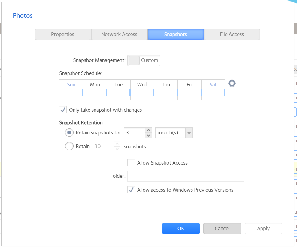

My own settings are attached.
These are daily, but are easily adapted to weekly by setting a different schedule. The 3 month retention is a bit arbitrary - it's a balance between the disk space needed for the snapshots, and the desire for long retention. The idea is that if you see too much snapshot disk space for a share, you can adjust the retention downward (and of course you can increase it upwards if the disk space is ok).
As I mentioned earlier, I don't check "allow snapshot access" because I want to make sure the files in the snapshot read-only. Their purpose is to allow me to retrieve earlier versions of the file if something goes wrong. Since "allow snapshot access" makes the files in the snapshots writable, that defeats my purpose.
