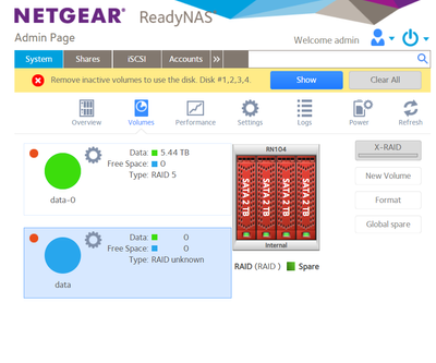

Hello Community, Yesterday I woke to a few Emails from my Ready Nas 104. There seemed to be an issue over night and the system went into a Data Unavailable state. This has caused a mayjor outage to...

Retired_Member wrote:
[23/06/17 23:51:14 AEST] notice:disk:LOGMSG_ADD_DISK Disk Model:ST2000DM001-1ER164 Serial:Z4Z1RPCQ was added to Channel 1 of the head unit.
[23/06/17 23:51:26 AEST] warning:disk:LOGMSG_DELETE_DISK Disk Model:ST2000DM001-1ER164 Serial:Z4Z1RPCQ was removed from Channel 1 of the head unit.
[23/06/17 23:51:30 AEST] warning:disk:LOGMSG_DELETE_DISK Disk Model:ST2000VX008-2E3164 Serial:Z52AZ56J was removed from Channel 3 of the head unit.
[23/06/18 05:43:36 AEST] warning:disk:LOGMSG_DELETE_DISK Disk Model:ST2000DM001-1ER164 Serial:Z4Z2HSZT was removed from Channel 4 of the head unit.
Can you confirm that no one added/removed these disks?
I'd start by powering down the NAS. Remove the disks labeling by slot. Then connect them to a PC (either with SATA or a USB adapter/dock) and test then with Seatools. If the short test passes, run the full test.

I am 100% sure they were not removed. There was a power issue with the powersupply not connected correctly. I't been plugged in since 2015 and the main to the stepdown was llose. So I am 90% sure that was the issue.
The NS104 console has disk test. Do you know some reason that is not good to use to test?
Any ideas on getting the volume online without having to pull the disks?

But normally the disk test is on the volume settings wheel - not sure if you can run it. But it would be reasonable to do it if the system will let you.
It would also be good to download the log zip file from the logs page.

Is ssh enabled on the NAS?
Do you have any experience with the linux command line?

I have the log bundle already. SSH is not enabled and I can't enable it becasue the volume is not online.
