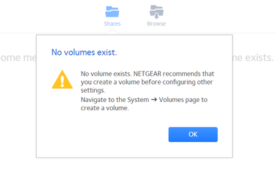

Hello Community, Yesterday I woke to a few Emails from my Ready Nas 104. There seemed to be an issue over night and the system went into a Data Unavailable state. This has caused a mayjor outage to...

I have the log bundle already. SSH is not enabled and I can't enable it becasue the volume is not online.
- Retired_MemberJun 19, 2023
No Volume Exists for RAID. I know it will be there. It is just a matter of telling the system the volume exists. Is there any way to fsck the disks. I don't know if an OS reinstall will help with this.

Retired_Member wrote:
No Volume Exists for RAID. It is just a matter of telling the system the volume exists.
Well, not really. There are a couple of scenarios.
One is that the power surge damaged the disks - the disk test would let you know that.
A second is that there were disk writes cached in RAM that were lost when the power was cut. This would result in an out-of-sync RAID array that won't mount. It is possible to forcibly mount the array, but there can be file system corruption because of the lost writes. This could just be some errors in a file. Or it could be worse - if a directory wasn't re-written properly, you could lose a lot more.
