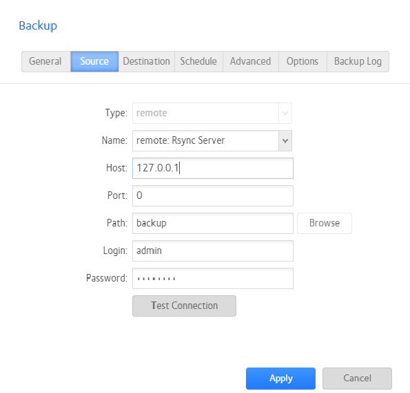

Let's assume that you want to backup a particular share (backup), and that the backup job is also called backup.

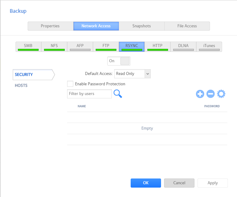

First enable rsync as a protocol on the share:
Next edit the backup job source settings:

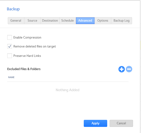

Edit the backup job advanced settings to set "remove deleted files on target":

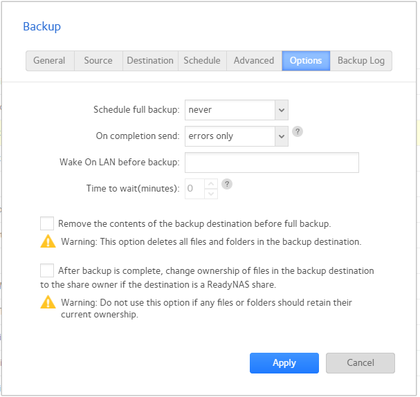

change the "schedule full backup" to "never":
This last bit just prevents the backup from doing a full backup the next time it is run. I'm not certain it's needed.
- Limerick_frSep 29, 2020Guide
Hi StephenB,
Thank you very much for your step by step description.
I guess I understood and manage to successfully test the connection.
