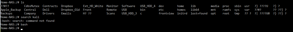

I downloaded ssh and did an ls command. Here is the output. Can you advise what you see here? I am concerned as l have allot of folders that appear to have these ?? folders but l cannot cd into them. Any advice?
