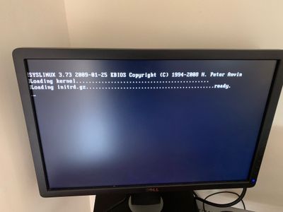

Using OS4 usb recovery tools, as admin. With renamed OS6 image file.
Boots, loads kernel, hangs.
Disappointment
