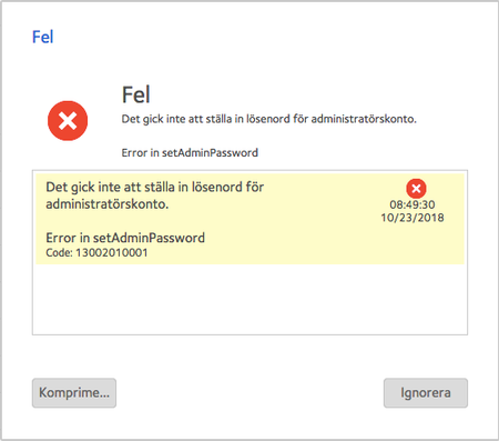

Problem changing Admin password
Hi,
Hav problem to change admin password. It worked earlyer but now I cant change it any more. And I can not add a new user.
Any ideés?
Kind regards,
/Sören

You might need to do an OS reinstall. That will reset the admin password back to password. It will also reset the network configuration to the default settings, and turn off volume quota.

Hi,
I get a nother tips. Log in with ssh on the unit and enter "passwd" and that worked. Now I have changed the password without doing a OS reinstall.
It doesn't generally work. I'm thinking that something you did resulted in changing the password to that value.
- SorenBOct 24, 2018Aspirant
Still I can't change password from the web interface. But now how I can change via ssh it's ok for me.
