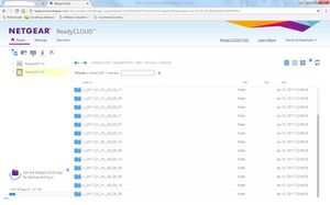

I am running an RN526X with firmware 6.6.1. After a lot of help from this community I got the snapshots working correctly. My system takes a daily snapshot of all of the shares (except the Home fol...
