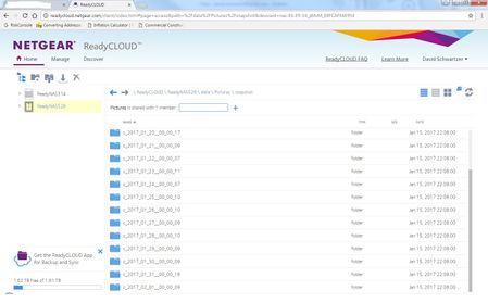

I am running an RN526X with firmware 6.6.1. After a lot of help from this community I got the snapshots working correctly. My system takes a daily snapshot of all of the shares (except the Home fol...

I have disabled disk spindown and will see what happens tonight. Either way, I am confused by what the Snapshot page says and what I would be seeing.
Is there some naming convention that distinguishes a daily snapshot from a weekly snapshot or monthly snapshot? Do all the folder look the same? How do I know which are daily, weekly and monthly?

That did not have any effect on the snapshots being promoted. The folders appear the same as my screenshot above except it now has an additional dolder for the 2/2/2017 snapshot.
