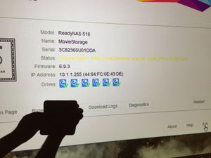

Raid level Unknown - ReadyNAS 516
A friend/customer of mine did a firmware update in the weekend. After it rebooted it worked as per normal. You can read/write to the drive and use it normally and RAIDar report that all is OK. BUT wh...

What do you see under System > Volumes in the web admin interface?
- Kev75Mar 19, 2018Aspirant
You cannot click on the Volumes button or any other once logged in.
I will personally take a look at it tonight to ensure what he is telling me is the same as reality
