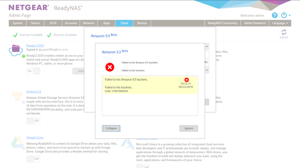

 Amazon s3 in my readynas 316 was working till 18/6/2018 properly. Now its showing an  error. Amazon s3 Indicator is red in colour ,displaying a message "authorisation failed. No space available. Tried switching off and on from different browsers and computers. Tried restarting the NAS device.Also tried to reconfigure the S3 by leaving and adding the access keys and Secret Key. But now, its showing "failed to list Amazon S3 buckets. Failed to list buckets " with an error code 37007000029. Tried  this from  different different computers and browsers. Buckets are loading when installed cloudberry appin the computer and configured the S3 backup . So no problem with the internet connections or ports or firewall .
S3 aws console is accesible trhough browser. Please guide us with a solution other than "try from another computer, another browser ".
Please find below the scereenshot. Readynas firmwire version is 6.9.3.
  • There nothing related to this in the logs.. Anyway I think, I have found the problem and I fixed the same. When I checked, the NAS time was approx 20 minutes faster than actual time.  When I fixed it, NAS immediately started the syncing.
