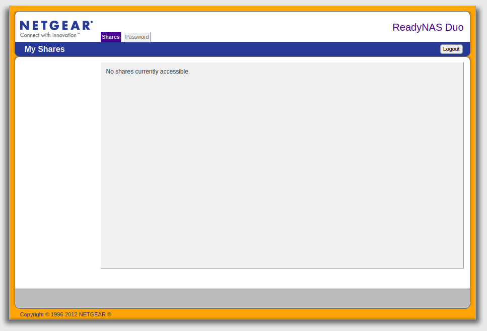

- Rob_MApr 15, 2022Aspirant
Thanks again, Steven.
I tried again to login using the netgear1 password, and that worked fine. I can now connect. I changed the admin password (of course) at this first login, but I've basically got a blank interface telling me I don't have any shares. See attached image at the foot of this message.
Looking on the underside of the unit there's a silver label identifying it as: RND2000 v2 (although the front panel states Ready NAS Duo). So, we seem to be getting there... slowly but surely. Thank you so much for your time and patience, Steven.
- StephenBApr 16, 2022Guru - Experienced User
That is one reason why the v2 branding was confusing. You definitely have the original Duo (which runs 4.1.x firmware). The final firmware was 4.1.16 (which can be found here: https://kb.netgear.com/000038792/RAIDiator-Version-4-1-16-Sparc
That's because you aren't browsing to https://nas-ip-address/admin
The /admin is required to get you into Frontview.
BTW, the screen doesn't mean you have no shares - there were shares created during installation. It means that you have no shares that are set up to be browsed via http.
