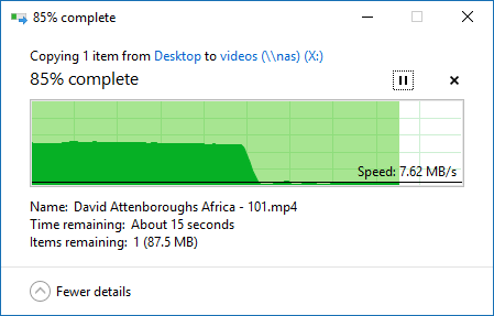

Right further more, I did a quick test this morning and the expected behavour of the fault appears to be back, strange how it was fine after switching mode but non the less, for example, here is the file transfer from a test file:
Starts off fine then drop to single digits as per earlier post. I will have to get a test done where it isn't using a teamed NIC.

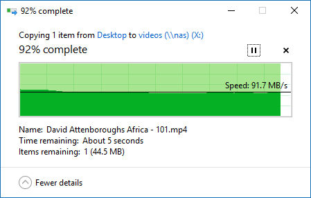

- VezJan 02, 2018Aspirant
and one without the Bond, this suggests that the bonding issue puported fixed in 6.9.1 still has issues.
