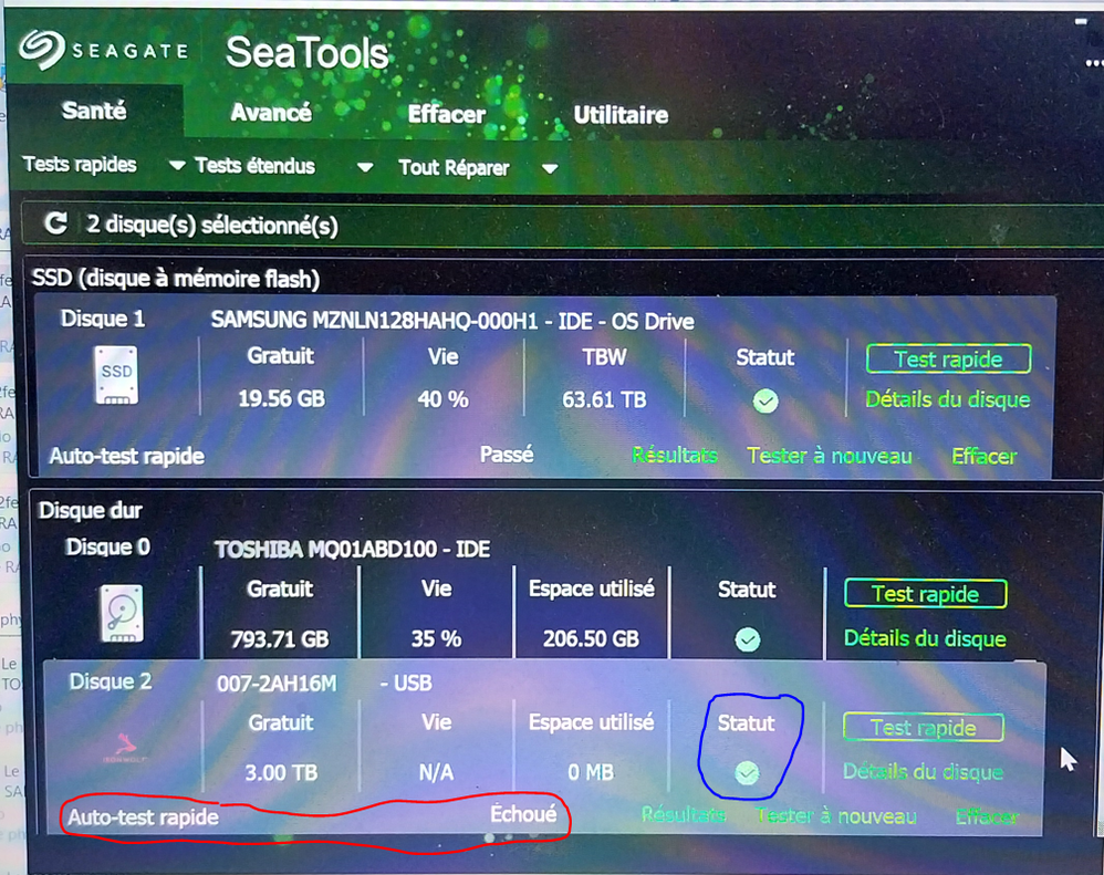

I have checked disks 1 by 1 with Sata to USB adapter. All disks starts properly. No electrical issue during the check.
all the disks are OK using seatool from seagate. No error message.

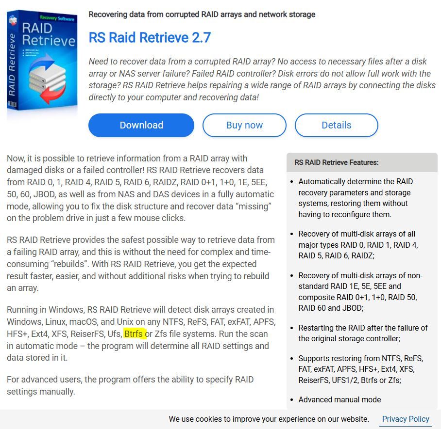

I have also used rs raid retrieve software which is new for me. Below, kind of informations it gives. On the four disks i have this screen. The software find 15244 files for each disks tested. There is one difference i don't understand. On the first disk, image below, you can see 3 disks on matrices RAID but when i analyzed the 3 other disks rs raid retrieve found 4 disks !!
disk 1 on RAIDdisk 4 on RAID
rs raid retrive exploring the disk i don't find my files for example pictures or films etc
files retrieve in one folder.... other folders have this kind of files but no jpeg or mp4

glooz1 wrote:rs raid retrive exploring the disk i don't find my files for example pictures or films etc
There are multiple RAID arrays on the disks. You appear to be looking at the OS partition (a 4 gb volume), and not the data volume.
Data offload with RAID recovery software will require that you connect all the disks to the PC, not just one at a time.
Aslo it will require that you use recovery software that supports the BTRFS file system. The OS partition is EXT, but the data volume is BTRFS.

I don't know seatools. I want to test disks but the result was failed for all the disks. I'm not sure that it did the test!! Maybe there is somethink which blocks the test?! the status is OK (surrounded in blue). In disk detail, the same. all is OK!

glooz1 wrote:
I don't know what BTRFS is? Which software can i use to go on?
There are several file systems that are used by various computers - FAT32, NTFS, ExFAT are used in Windows; EXT, BTRFS, and others are used by Linux (which is what the NAS runs).
I'm not sure exactly what "rs" is - if this is R-Studio ( https://www.r-tt.com/ ) then, it does not support BTRFS. ReclaiMe is a package several here have used with success - though there are some other packages out there that also support BTRFS.
A little tricky for me, since I do not speak French!
The control on the right next to each disk runs the "quick text". That doesn't fully test the disk, it is more of a confidence test.
If you select the disk first, and then go to the "Extended Tests" pulldown (second from the left at the top), then the middle option in English is "Long Generic Test". That will completely test the disk, so it will take some hours (unless it fails)

OK but 100$ it's a lot more over if i have to add 100$ more for a retrieve software and 70$ for the second chassis .....
The soft i'm using is
It does the job but i didn't purchase so i have the free version and I think that btrfs files are viewed purchaising the software. I suppose Reclaime also.
about seatool, i will try what you said to see!

Other item, do you know why with rs raid retrieve, when i check the first disk, it finds 3 disks on the raid and not 4 disks?
