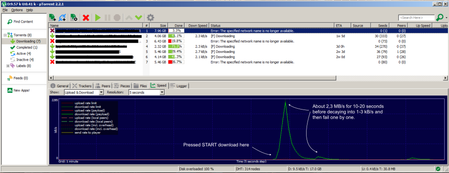

Hi guys,
I have been reading this whole 16 page thread and almost feel that i got to know you by now.
Anyways, it has been very helpful to read about all of your attempts and "beta testing" s...
