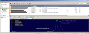

This morning when I logged in to the GUI to reboot it, there was a message saying that defrag for Octagon was complete.
So despite the error message (and lacking "defragmentation started" message in the log) it actually started and run.
That can explain the lacking writing performance of the volume and the overall reduced reading performace from the NAS.
Now things looks much better. I will anyway perform a reboot later today when the current writing operation are finished
