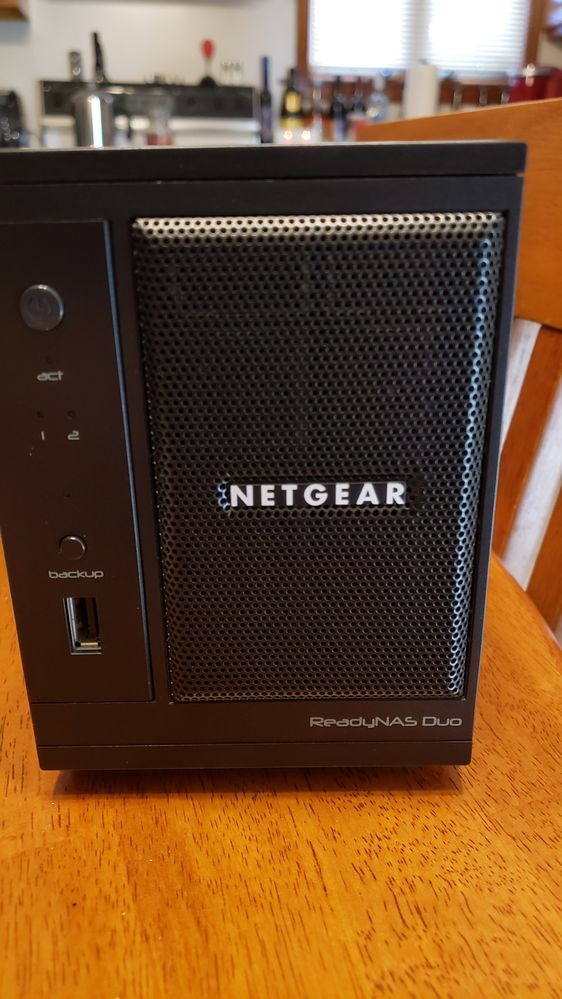

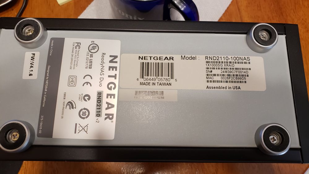

StephenB
Jan 10, 2019Guru - Experienced User
WTAr7k wrote:It's definitely a Duo.
Good. There are two quite different Duo platforms - the original Duo (called Duo v1 here) and the Duo v2. The Duo v2 was introduced in November 2011 (replacing the original Duo).
The Duo v1
- runs 4.1.x firmware
- says ReadyNAS Duo on the front panel
- might have v2 labels on the back or side
The Duo v2
- runs 5.3.x firmware
- says ReadyNAS Duo v2 on the front panel
The Duo v1 is limited to disks of 2 TB or less. The Duo v2 can handle much larger disks. There are posts here from folks who sucessfully installed 6 TB drives. One person did run into trouble with 8 TB (though that might have been due to faulty drives).
Overall, NAS-purposed disks are the best choice for your NAS - Western Digital Red and Seagate Ironwolf will both work well. Enterprise class will of course also work, but your NAS isn't fast enough to take full advantage of them.
The HCL is available btw, but it hasn't been updated in many years - so it is not a useful guide anymore.

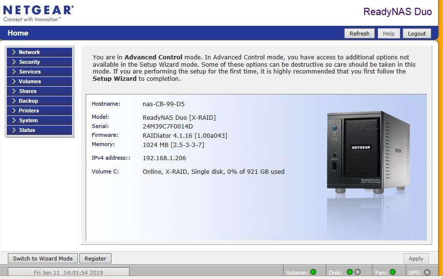

- WTAr7kJan 11, 2019Aspirant
Stephen,
A couple of pix for reference.
Hey Stephen,
I was able to bring up the Duo with a scratch drive I had laying around,,
I have 2 Red 2TB's coming tomorrow. I post the progress.
Thanks again for the assistance.
Bill
