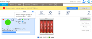

Hi all! I have a similar problem: error 1014019995 Model ReaduNAS 214 Firmware 6.10.6 Type RAID5 How can I solve this problem and restore the data? ...
