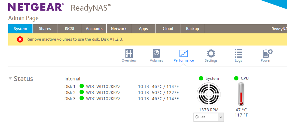

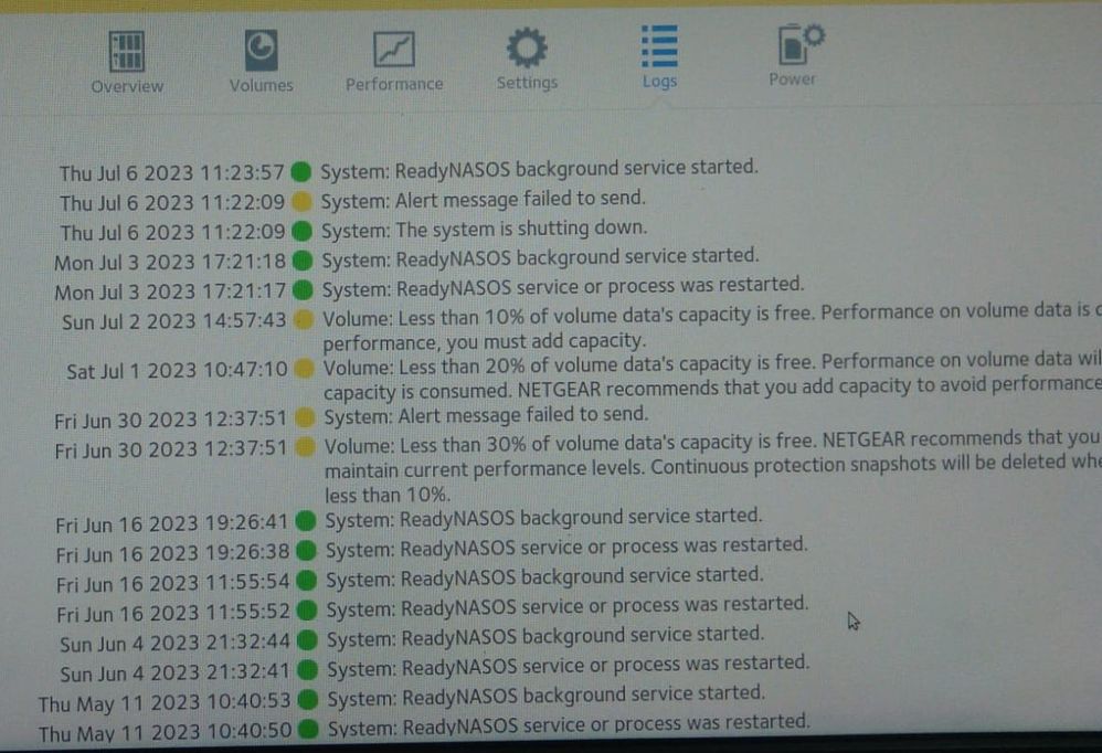

- kodandaJul 06, 2023Aspirant
Dear StephenB,
I had exact problem with my NAS 214. It was all working fine, but suddenly all the three (it has 3 disks) disks started to show up as red. The health indicator shows green. There was a power failure in between. We have some important data. I am comfortable with command line, I have been a linux user for sometime. Could you please help?
The log file is also attached.
Cheers,
Kodanda
- StephenBJul 06, 2023Guru - Experienced User
Likely it was the power problem.
Can you download the full log zip file, and then put it into cloud storage (drop box, google drive etc)?
Then send a download link in a private message (PM) to me. You can use the envelope link in the upper right of the forum page.
