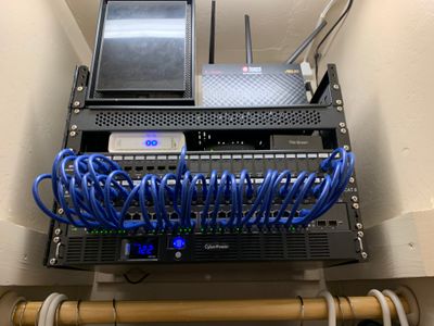

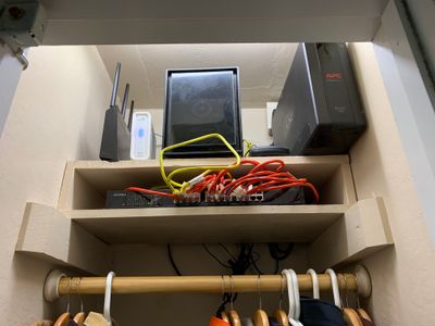

The NAS is in Sleep mode a lot of the time, and late night, it powers down. I also a couple weeks ago Upgraded my Home wired Network. From what I did 5 years ago when I got my house, to what it is now, which looks professional. Something I had been planning to do for the last 6 months. I had a few wiring issues and decided to fix and upgrade the whole thing. I also ran another 9 Ethernet cables under my house. 2 to the Garage for my future IP POE Security Camera's I have planned. All the work I did myself with ZERO help. What you can't see if the Hole I had to cut out in the door header where there's a dual fan setup that is temp controlled. The fans are attached to this wood grill that's painted to match the hallway. So blends in, It's also pretty quiet. If it gets to warm in that small closet, the fans come on, on their own blowing air out. There's about a 1" or so gap under the door for the cooler fresh air to go in. Heat rises after all. The fan setup has worked well for my needs for the last 5 years.
Running new cables also allows me to toss a couple small switches that I now no longer need. My used Fluke Networks MS2-100 Cable Tester allowed me to test everything from point A to point B. Which I did do a couple booboo's and then corrected.
This is my before Home Network. You can see my ReadyNAS 516 up top in the middle. There's also a ASUS Router I want to upgrade soon, a cable modem, a HD Homerun, a APC UPS, and a Zyxel 24 port Managed Switch, and next to the switch on the right you can't see a Tivo Stream.This is what it looks now NOW. My ReadyNAS 516 on the top left. My ASUS Wifi Router next to it. Under that my cable modem, HD Homerun and the Tivo Stream. Then there are a couple Cat6 Patch panels. A new Zyxel 48 port Managed Switch. I like these because they work great. The price is reasonable and best of all, they are not DEEP. It's a little less deep that that Cyber Power UPS pm the bottom, which the NAS is plugged into by USB. If the power goes out, the NAS will auto power down on it's own safely. I'm using a 8U Wall Rack that has 1 side hinged on the front, and the sides are adjustable. I have them all the way out to the max of 13.5" in depth.
