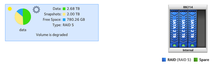

ReadyNAS 214 won't recognize replaced drive
RN214 I've had for a number of years had its first disk issues: lots of ATA errors for disk 4 and "degraded" status for the RAID-5 volume. I bought two new drives from Newegg (Toshiba DT01ACA200, sam...

Have you tried connecting the new drives to a PC (either SATA or a USB adapter/dock) to see if they work? Though two dead-on-arrival disks isn't all that likely, it is possible that something happened during shipment.
Another option is to power down the NAS, and remove the disks (labeling by slot). Then put one of the new disks in slot one by itself, power up, and see if you get a fresh factory install. If you do, power down again and more the disk to slot 4, and see if the system boots normally. If it does, then use the disk test on the volume settings wheel to fully test the disk (that will take a couple hours to complete).
When done with this test, make sure you destroy the volume from the volume tab menu (and maybe for good measure reformat the disk).
