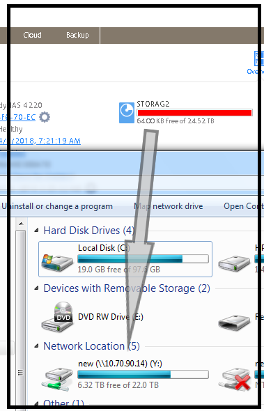

I'll duble check all logs , another qustion please why the admin page show the storage was full while there was afree space on it .
