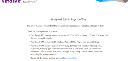

ReadyNAS "Admin Page" is offline
HI All,
I have recently purchased ReadyNas 214 after i upgaraded the firmware to 6.6.1 i am unable to get the admin page.
Both the network interface our configured with the same IP.

On NETGEAR RAIDar i am getting error that the management service is offline.
- StephenBApr 06, 2017Guru - Experienced User
Does https://ip.address.of.nas/fwbroker respond? If so, try the 6.7 install that mdgm suggested earlier.
If not, try an OS reinstall and see if that brings the admin page back.
