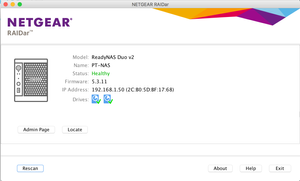

Hello, I am running El Capitan (OSX 10.11) on my Mac laptop. I have 3 shares on my ReadyNAS Duo V2, using the latest version of RAIDar (6.1) I can see the device (which is plugged into the ro...
- Jan 26, 2016
I just checked and I can connect to my Duo v2 via AFP without any issue. I am running 10.11.2 at the moment.
This sounds like a discovery issue. You might want to try globally turning off the AFP service then starting it again.In the Finder if you go to Go > Connect to Server, can you connect to afp://192.168.1.50 ?

Try to disable and enable the AFP protocol on those shares and once enabled, ensure Everyone is set to R/W and the Allow Anonymous Access checkbox is ticked. Resetting the permission of the said share is also a procedure you can try if the above suggestion didn't work.
Device Software Manual - check pages 33-35
