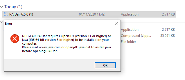

Thanks for RAIDar link, I downloaded 6.5, but I received a popup " netgear raider requires openJDK (version 11 or higher)......please visit java.
https://www.downloads.netgear.com/files/GDC/READYNAS-COMMON/RAIDar_6.5.0.exe
Also maybe I need to download earlier versions depending on what you respond if V2 or not.
Is this a Windows PC or a Mac? What version of Windows (or MacOS) is the PC running?

Sorry yes I meant RAIDar to be able to disover NAS. I cannot browse to NAS IP even though I can ping it from PC.
Running Windows 10 pro.I haven't had any issues installing RAIDar on my own Win10 systems. Do you have internet security software (Avast or Kaspersky for instance) that might be getting in the way?

kixkm wrote:Sorry yes I meant RAIDar to be able to disover NAS. I cannot browse to NAS IP even though I can ping it from PC.
But there is one issue regarding file access with Win10. Microsoft is deprecating the SMB 1 protocol that your NAS uses. Go into "turn windows features on or off" on the PC, and if the SMB 1 client isn't enabled, then enable it. The protocol isn't considered secure (there's a reason Microsoft is deprecating it), but IMO it is safe to use on a home network. In any event, it needs to be enabled in order for you to access the NAS.
The RAIDar link I tried previously was the correct one. Still receiving this error below, also you will see the filename I downloaded. I do have Norton installed but not sure if its that, SMB but looks to be java related.Once done, then enter \\nas-ip-addess in file explorer's address bar (using the real IP address of course). Also be care to use the correct slash direction. Then see if that gives you access to your shares.
