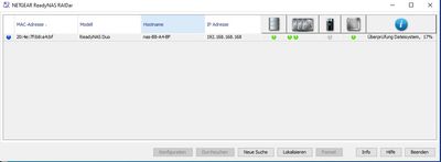

Notebook -> WIFI  192.168.10.xx -> Raidar shows device as in the screenshot (192.168.168.168) -> After 100% is reached, it vanishes and is not to be found anymore.

    RAIDar is saying you have the original Duo (Spark CPU), not the later v2.  Though the labeling can be very misleading.  A v2 in the part number just means a small hardware revision (not the second generation platform, which is very different from the original, and runs completely different firmware).
    It looks like it is doing a file system check when it is operational - not sure if that is failing later on, or not.

    • michiw1's avatar
      michiw1
      Thank you for your answer.
      Yes it stays visible with the 192.168.168.168 IP.
      the status is something “Discs missing”. (Direct translation “no harddrives recognized”).
      Via direct LAN connection, it’s still not possible to open admin page.
      Edit: ping 192.168.168.168 works.
