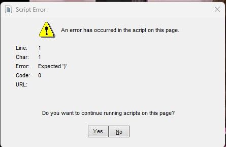

rozel1
Feb 13, 2023Aspirant
Good morning
Yes, the first screenshot is the error when currently trying to install RAIDar version 4.3.8, the second one is trying to installJava: -
I am getting the Java files from here: - https://www.java.com/en/download/manual.jsp
Perhaps you would be so kind as to point me to a suitable Java Download that won't give me the Script error please? I am running Windows 11 64-bit. It's a case of trial and error at the moment, not knowing what Java to install - all seem to give this error.
StephenB
Feb 13, 2023Guru - Experienced User
The problem is that you need an old version of java - which is a pain.
This runtime binary will work:
Note you can also get the runtime sdk from Oracle, but you need to create an Oracle account to download it.
This is in the second section (titled "Java SE Runtime Environment 8u202"). It appears to be a bit older than the first link (which is version 221) - no idea why that is the caes.
If you ever uninstall this stuff, you need to uninstall RAIDar first, as the uninstall will fail if it can't find the java runtime.
- rozel1Feb 13, 2023Aspirant
100% perfect - thank you!

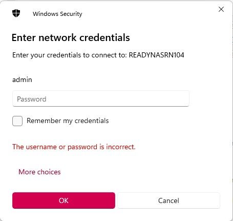

Nope! Transfer - appx 24GB started well but bombed out and now it's asking for Windows Credentials: -
So what now? Obviously tried the credentials associated with my NAS - not seen this before. And why did the transfer start but then bomb about 5 mins later? Windows Explorer is also preventing me accessing, again with this request
- StephenBFeb 13, 2023Guru - Experienced User
rozel1 wrote:
Connected it to the RN104 logged in through PC and configured it just as I've done with my other Network Shared Folders, albeit it shows up as an external source.
Normally it will do that with a normal external hard drive, but not with a RAID array. Just guessing here, but you might have a SAN solution with hardware RAID that looks like a normal USB drive to the NAS.
You could enter the NAS admin password and see what happens.
I've tried entering the ReadyNas's credentials to no avail. You said: -
"Normally it will do that with a normal external hard drive, but not with a RAID array. Just guessing here, but you might have a SAN solution with hardware RAID that looks like a normal USB drive to the NAS."
Can you explain what you mean exactly. Are you saying I cannot attach a Raid Array (it's a Yottamaster) to the RN104? What do you mean by "SAN" solution?
I've just logged in via 2 browsers both accepted the ReadyNas Credentials but sadly the "External" USB HDD does not show. In Windows Explorer Explorer after disconnecting from the RN104 and back into the PC what was supposedly transferred previously before the transfer bombed out is not available to view, resulting in me having to reformat as a normal HDD - am currently back to where I was before connecting the Yottamaster to the RN104.
I'm troubled now because I cannot log into the RN104 via Windows Explorer. Thankfully my Media Server is seeing the Shares. Any thoughts how I can get Explorer to work again please? Sorry for this, just thought I could connect the Yottamaster
