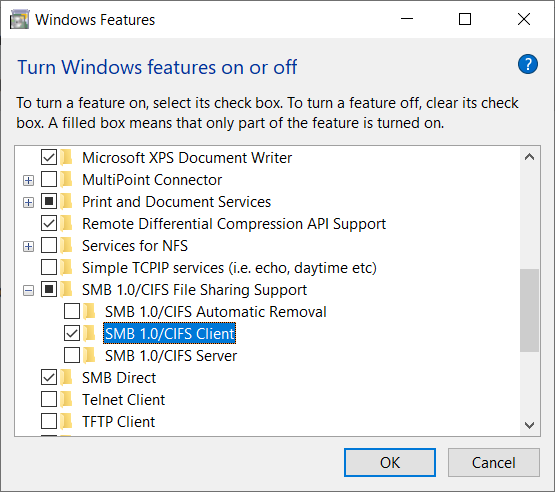

Go into "turn windows features on or off" on the PC (just type it into the windows search bar). Enable the SMB 1.0 client - no need to match other settings in the screen shot. You will get a security warning, that you need to ignore.

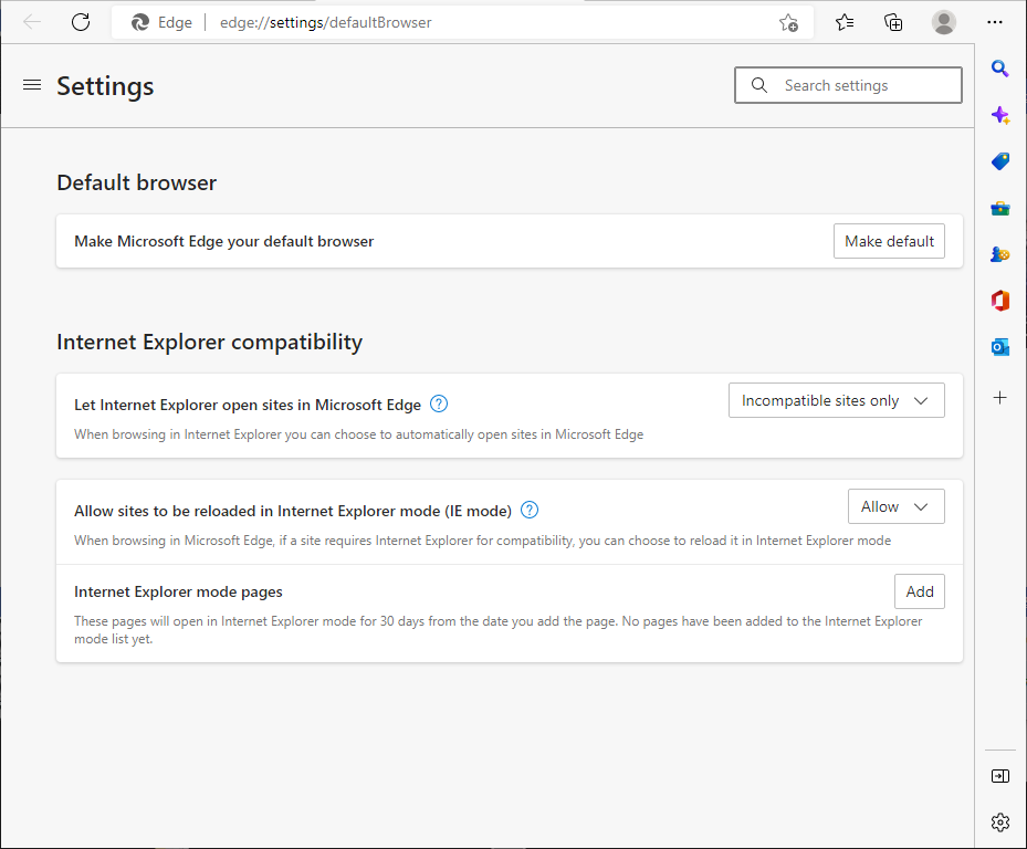

Have you tried navigating to edge://settings/defaultBrowser in edge? You'll need to copy/paste this into the browser address bar - or retype it. Edge will block it if you just click on it.
Then click "add" at the bottom, and add the URLs for your dashboards.

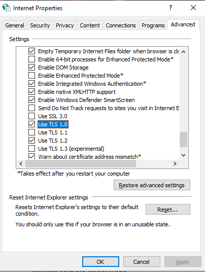

First type the Win key + R together on the keyboard:
Enter "inetcpl.cpl" in the "open" box, and click on OK. That will open up this screen:
Scroll down to the "Use TLS 1.0" setting, and make sure it is checked. Then click on "OK".
Now on to Edge. First make sure the setting to enable IE compatibility is set.
You can just type "edge://settings/defaultBrowser" in the address bar to get to the above page. Make sure "allow sites to be reloaded in Internet Explorer mode" is set to "Allow".

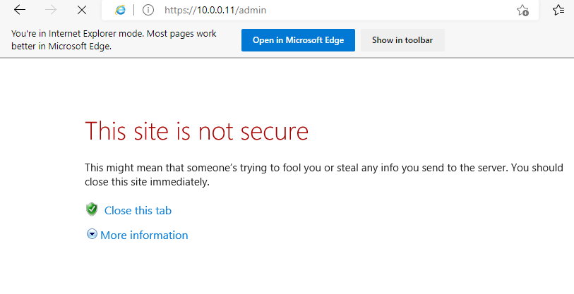

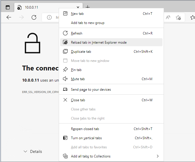

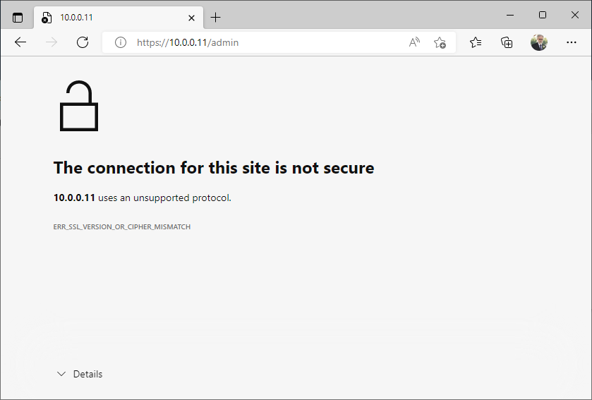

Now browse to the dashboard (https://nas-ip-address/admin). You should see this:
Right click on the browser tab at the top:

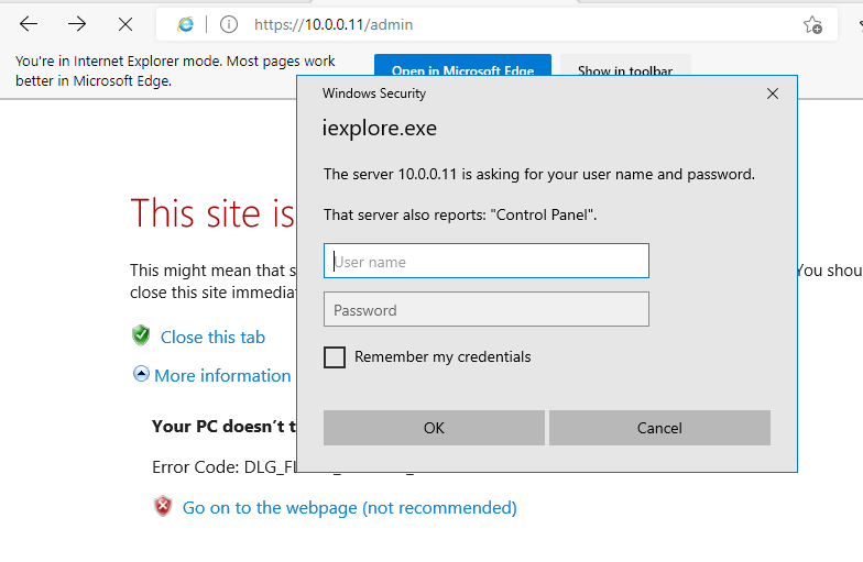

Select "reload page in Internet Explorer Mode". At this point I see this:

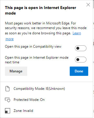

I chose the first option ("Open this page in Compatibility view") and then "Done". You could select "open this page in Internet Explorer mode next time" as well if you want (click on that option first). Then I see this:

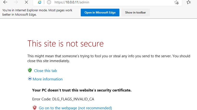

Click on "more information":

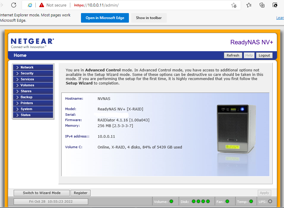

Your error code might be a bit different. But click on "go on to the webpage". I see this:
Now I enter "admin" in the user name field, and the NAS admin password. That brings me to NV+ v1 Frontview (and should bring you to the dashboard):
