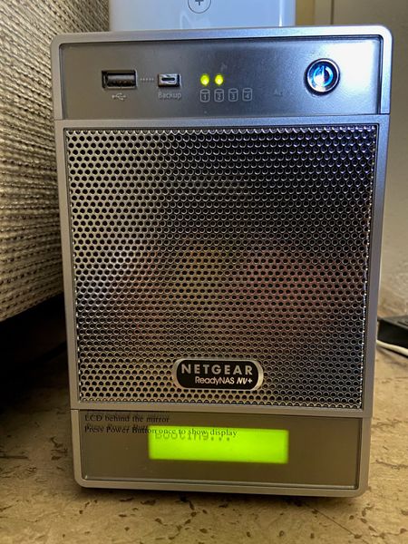

Thanks again. I removed firstly drive 1 and then restarted with disk 2 inserted (in its original slot #2),
the device LCD said:
"boooting..."
"Checking root FS"
"Checking FS"
"Quata chk: {counting}%"
and after that remains saying "booting..." (endlessly as it seems). Device not found with RAIDar. Forced shutdown.
Same procedure with just disk1 inserted (in its original slot #1). Exactly same behaviour and results as above, device not found with RAIDar. Forced shutdown.
Started again with no disks inserted, display says "ERR: no disks", 4 disk LEDs are flashing in the following sequence: all 4 LED on / off / LED disk2 on / off / all 4 LED on
Device is accessible in this state with RAIDar, however it is not via browser:
What do you suggest to do now (did not check the 2 2TB WD20EFRX SATA disks so far)?
