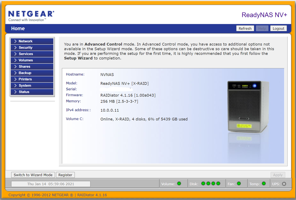

        You should see a log-on popup, and after you log in as admin you should see something like this:
        RAIDar should be able to tell you what firmware is on the NAS.  If the firmware is very old, it might not be compatible with current browsers, so it would be useful to know what it is running.  https://kb.netgear.com/20684/ReadyNAS-Downloads
