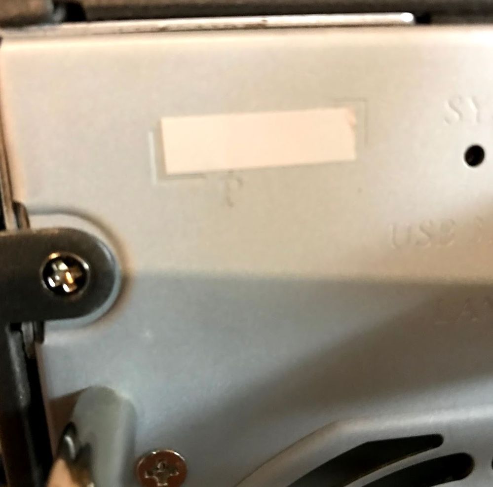

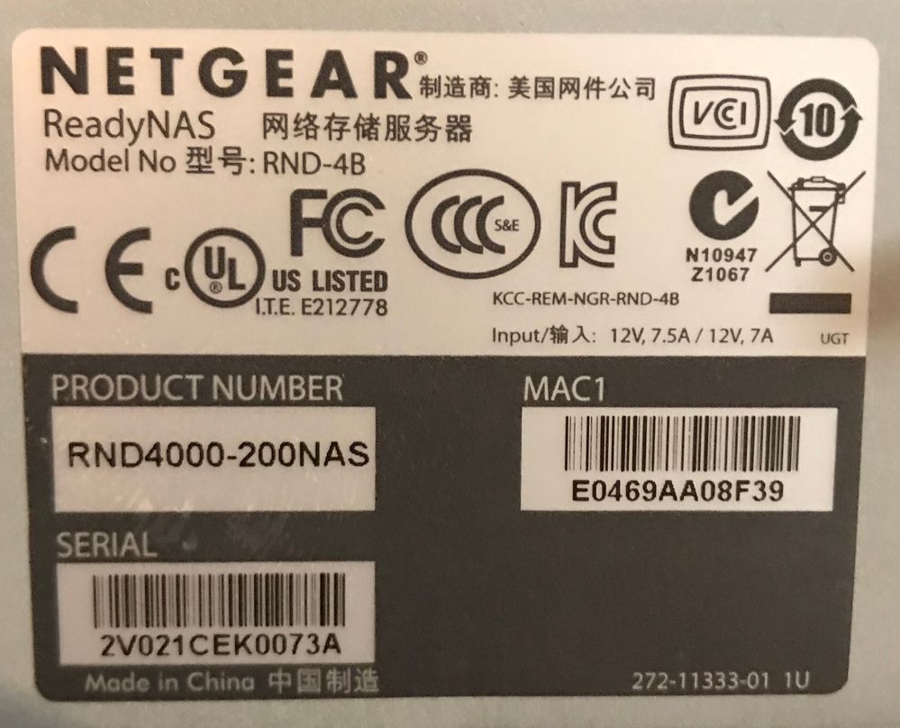

- chipsmithsonDec 06, 2017Aspirant
StephenB wrote:What I really want to know is whether your NAS runs 4.1.x firmware or 5.x.x firmware.
There's a sticker on the back that tells you the firmware that was shipped with the unit. Can you post that?
These were the only two stickers on the back and neither of them appear to have what you were looking for?
- StephenBDec 06, 2017Guru - Experienced User
That helps - the part number is definitely a v2 platform (arm processor), so you are running OS 5.x firmware.
