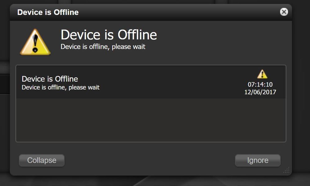

Okay,
Yes you are correct. I wasn't quite following the steps. When I did I was able to kick off the OS install. Now my problem is even after completing that process. Hitting the admin page, I still am confronted witht the following: :(
