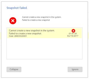

ReadyNAS os 6.6.1 problem with snapshot
Hi, I have problems with FW:6.6.1 I saw in logs that snapshots are not created for one share. So I was trying to make manual one, and i get error Code .28003020001 This share is compr...

Hi,
manual is not working, auto is not working.
For new share it is working fine with this same settings, and of course for all other shares.
I solve this problem creating new share. But I do not know if this problem will return or not, that is why I would like to know what this error means. It will takes some time until I will have full copy of my previous share ( it is almost 1TB of compressed data with 1M files, so I am copying files slowly without impact on production)
