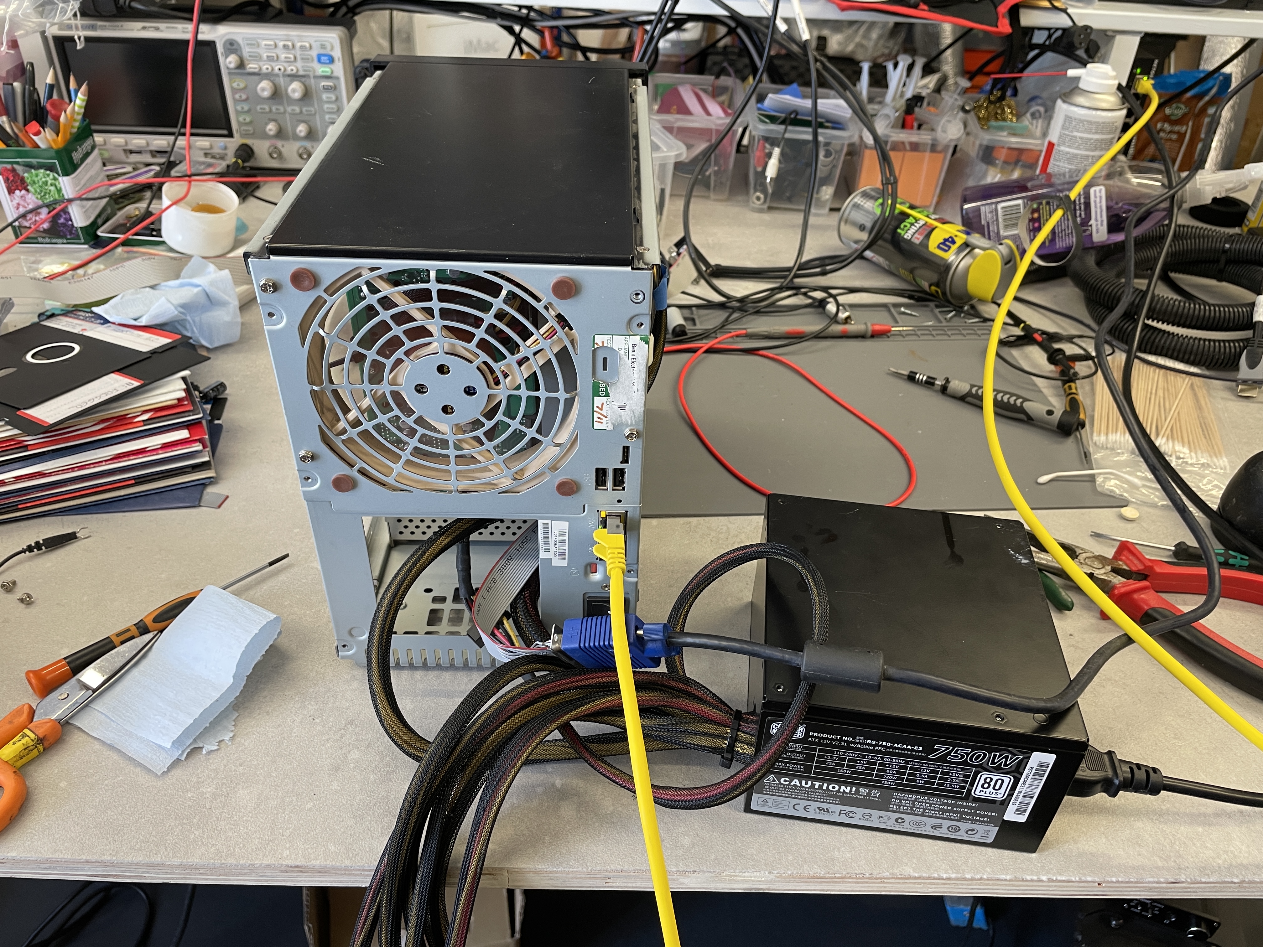

Cooler Master 750W ATX PSU is in. First thing I noticed is that upon power up HDD0 failed to show up - so it's not a PSU issue. I'm wondering if it's a red herring here or maybe HDD0 is having some issues. Maybe the MB fails to recognise it but by the time the OS has started it's managed to come back to life. (I've compare the spin up time of SDA and it's identical to SDB).
Second: I've now tried thee different monitors and none displays any VGA output after the OS has botted up. One showed some "noise" as if the signal was not locked on properly. But I could not improve it.
I haven't touched the HDD yet, I want to see what happens with this PSU first. If it fails again, I'll work on the HDD.

Sigh. The NAS disappeared from the network again, this is with the ATX power supply.
I rebooted via terminal (blindly) and took a video of the POST. HDD0 was correctly detected.
This is incredibly frustrating! I guess I can remove the PSU from the equation, that leaves the HDD - but even that is guesswork.
Sandshark any more ideas about displaying the UI on VGA? It would definitely help to see what's working and what's not when the NAS disappears from the network.

- tony359Jun 06, 2023Apprentice
The second NAS NIC would directly connect to the second NIC on my desktop. NIC1 and NIC2 are on a different network range of course.
For this test, the secondary NIC was physically unplugged - but configured and ready to go. When the NAS disappeared from the main network, I plugged the secondary cable to the NAS and I could see the NAS from my desktop.
I thought of keeping the second NAS NIC disconnected rather than always connected. I guess I'll leave them both on for a test - but one NIC is going through the switch and to the main network, the other is only directed connected to the desktop.
Under normal circumstances, I would only use one NIC on the NAS.
