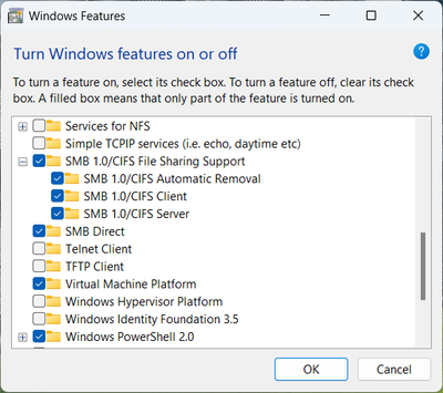

As schumaku says, you also need to make sure the CIFS/SMB 1 client is enabled in "turn windows features on or off".

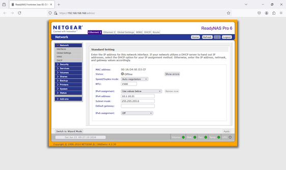

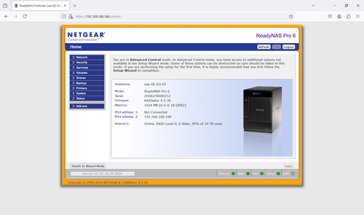

Thank you both! The Firefox solution worked. Here is the screen I can now access...
It has been many years since I was on Frontview. I never had the need.

I did the SMB1.0/CIFS thing after reading about that step elsewhere...

CustomVideoLLC great, don't forget to take away the SMB 1.0/CIFS Automatic Removal to avoid the unexpected.

Ok. I don't think this NAS ever had any shares. It was setup as the G-Drive on my old system. (Someone other than me obviously set it up!) When I moved locations about 6 years ago, the NAS was still working when directly plugged into the old system via ethernet port 1. I accessed it as I would any other connected external drive.
Here is the setting for ethernet 1...
and the setting for ethernet 2...

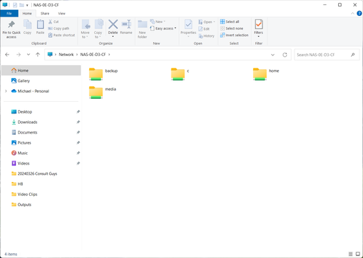

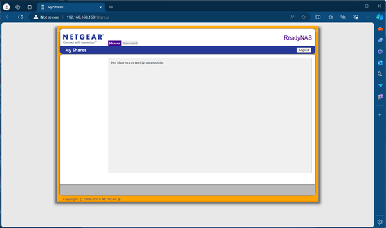

This is what I got when I accessed the NAS via file browser...

If you could access it over ethernet, then it had shares. These are either public or private home shares.
You need to find your files...
You accessed it the wrong way then (using your browser and NOT file explorer).
Try again with file explorer. Enter \\192.168.168.168 and see if you can get a list of shared folders (e.g. shares!) to access. The \\ is important. If you use // by mistake you'll end up with your third screen shot.
This is a static address that you must have set up yourself.
Do you recall doing it?
Do you know what IP address range your current router is using?

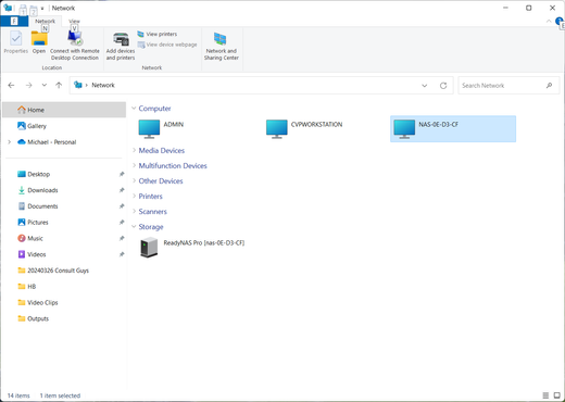

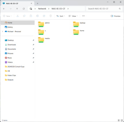

When I open with file explorer OR double click the icon below...
I get this screen with these shared folders...
Backup and media have NOTHING in them. C and Home need a user/password. Trying admin/netgear1 does not work. Tells me "access is denied". Trying my user/password for this computer tells me...
Again, on my old system, this NAS and my old computer were originally setup in a WORKGROUP, but as I said, once I moved locations, the NAS was working just by hooking it up to the computer via a yellow ethernet cable.
Also, this is the first time I am EVER seeing these "shared" folders. Like I said before, this NAS was setup as the "G" drive on the old system. I just double clicked on it and it opened to a window with regular file folders, nothing like these shared folders.

The tech likely set up the static 10.x.x.x. address on the NAS, and set up a compatible 10.x.x.x IP address on the ethernet port you were using on the old workstation.

Worth to configure an address in the 10.1.10.x/24 subnet and connect the other LAN interface, where you should be able to reach 10.1.10.21 (permitting I remember the IP addresses from the screenshots provided earlier).so for the PC different from .21, e.g. use .20.

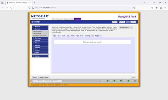

There is NOTHING listed under Users...

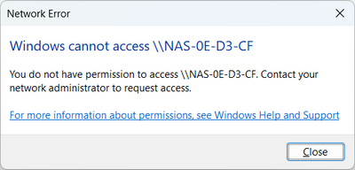

I changed the password for admin and now when I double click on the NAS-0E-D3-CF icon in the Network window I get this message...
Doesn't even show me the share folders anymore!

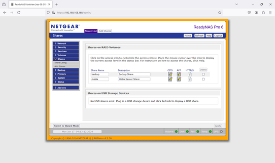

Here's what's listed under "Share Listing"...

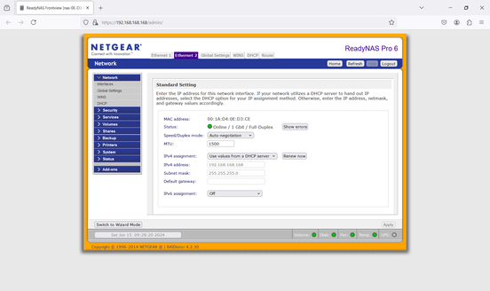

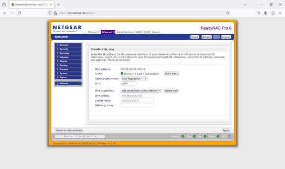

Also, while I was clicking around, I noticed this screen...
Ethernet 2, where the cable is attached, says to use values from a DHCP server. Should I change this to "use value below" and type in the numbers from below, which you told me to use for the ethernet connection on the computer?
IPv4
IP Address 192.168.168.100
Subnet mask 255.255.255.0
Gateway 192.168.168.168
Preferred DNS 8.8.8.8
Thanks!
- StephenBJun 17, 2024Guru - Experienced User
No. Just leave it as it is.

The fact that there are no user accounts on the NAS means that the files are not in a private home folder. So appears to be ruled out.

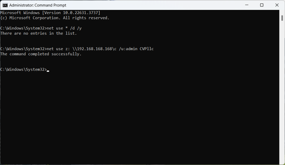

There are two approaches for the next step. The first is to run CMD (just enter it in the windows search bar) and enter the two commands I gave you before.
net use * /d /y net use z: \\192.168.168.168\c /u:admin NAS-ADMIN-PASSWORD
substituting the new NAS admin password for the NAS-ADMIN-PASSWORD placeholder.
If that works, it will mount the NAS data volume to drive letter C.

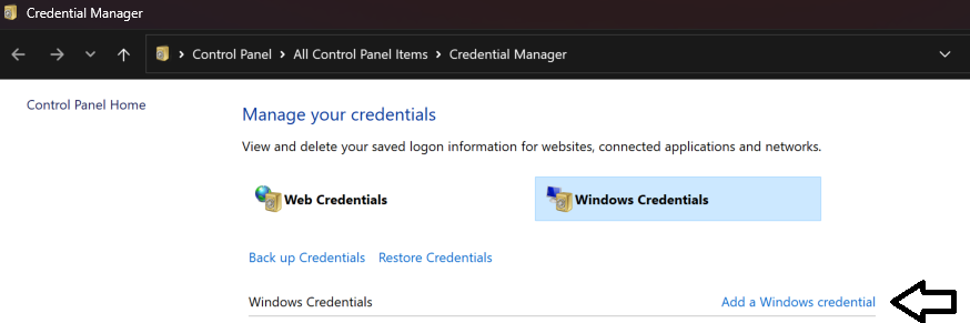

Another approach is to run the Windows Credentials Manager. Type "Credential Manager" in the windows search to find it. Then select "Windows Credentials", and select "Add a Windows Credential". This is in blue text in small print.
If there is a credential for \NAS-0E-D3-CF listed there, then delete it.
After checking for that, create a new credential for \\NAS-0E-D3-CF, entering "admin" for user name, and your new admin password for the password. Be careful on the typing, particularly the \\.
Then try clicking on that icon again in file explorer.

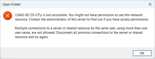

- CustomVideoLLCJun 17, 2024Tutor
Here's the results of the cmd window. What was supposed to happen?
In the Windows Credentials, there was a listing for "NAS-0E-D3-CF", as well as one for "192.168.168.168". I removed them both. Typed in the new ones as you said, and double clicked on the icon and got this again...
Ok. So, I logged out and logged back in. Now when I double clicked the icon I got this folder and I am able to look in ALL the folders now. However, there is nothing in any of them. Just some other empty folders or a README.txt message.
The data volume should now show up in file explorer as the "Z" drive. So look on Z for your files.

Got the computer back up and running. There is NO "Z" drive listed.
Can still see the "NAS-0E-D3-CF" icon in Network window.
Can still see the (now 5) shared folders. Nothing in any of them except other empty folders. The admin folder has a README.txt file in it that says...

The Z drive mounting wasn't persistant, so the two "net use" commands above would need to be re-entered in order to see that again. BUT, the credential manager did work, as you are now able to browse all the folders.

I reentered the commands... still no Z drive.
